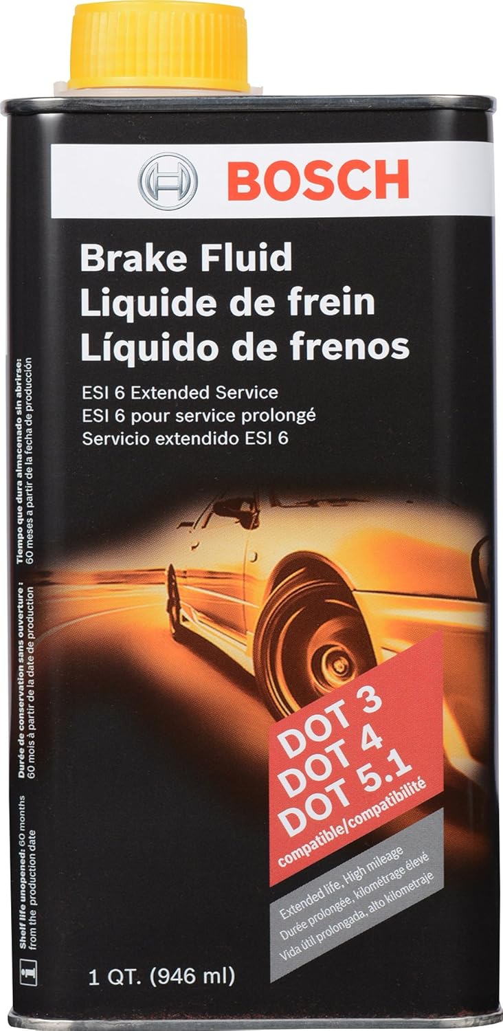

У Боша есть вот такая вот интересная тормозуха, описание:
 Style:  Dot 3-5.1
• High compatibility. Use with or direct replacement for DOT 3, DOT 4, and DOT 5.1
• Extended Service Interval (ESI): Lasts 100% longer than DOT 3, 50% longer than DOT 4, and 10% longer than DOT 5.1
• Exceeds all DOT 3, DOT 4, and DOT 5.1 standards
• Wet boiling point ~ 365 DegreeF/Viscosity at -40 DegreeC ~ 670mm2/s
Standard brake fluid has a recommended change interval of 2 years. The recommended change interval for Bosch ESI6 is 3 years.
